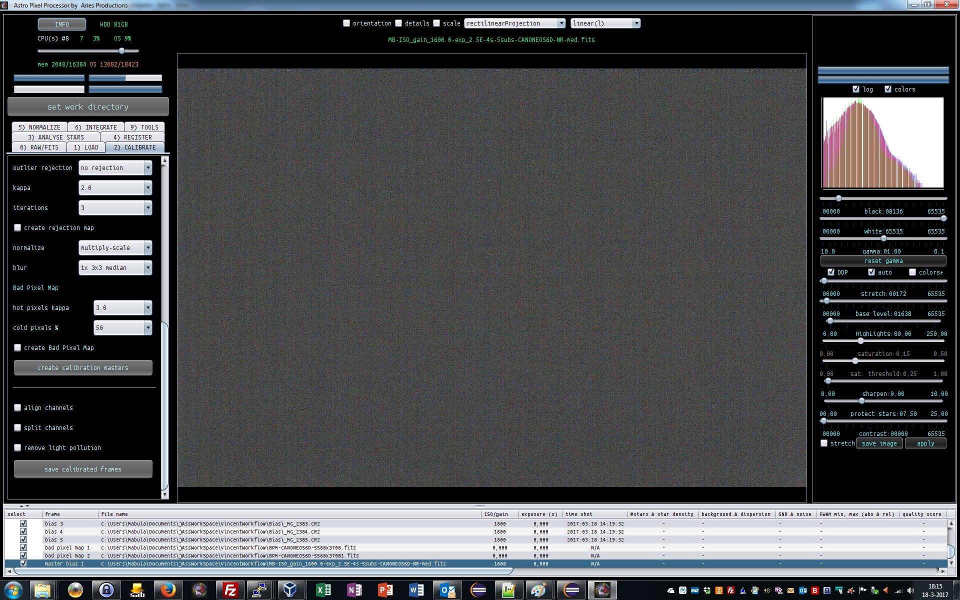

So first step is to make the master bias, we deselect the darks, flats, and lights and select the bias frames.
We set the master bias creation setttins at
2) CALIBRATE
Master bias
since I only work on 5 frames, i’ll do median combination without outlier rejection.
If you have plenty of bias, like 200-400 frames  (which you should have to make a good master bias) select average and outlier rejection with 1 iteration with a kappa of 3.

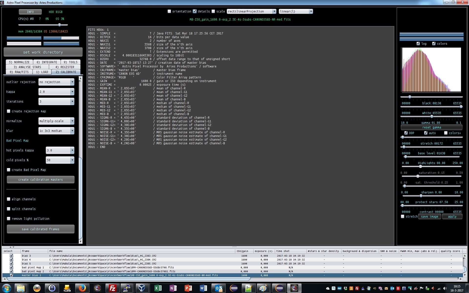

Click on create calibration masters, the master bias will be created now. In the FITS header we can see statistics of the master bias.  A bias and dark (or their masters can be viewed with DDP on now).
You’ll see that APP analysis the master bias on the CFA channels and pixels seperately ;-)
