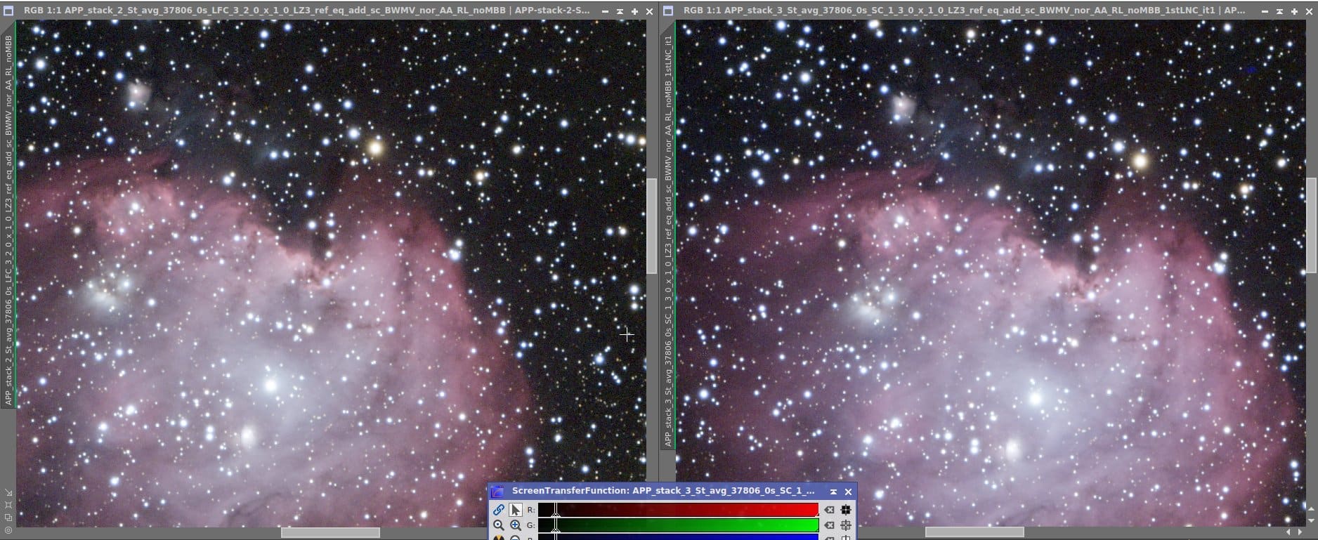

    #13809
    Yes i can see a visual improvement in noise level between stack 2 (left) and stack 3 (right). I will post-process stack 3 this morning in PI and upload the result to our Dropbox.
