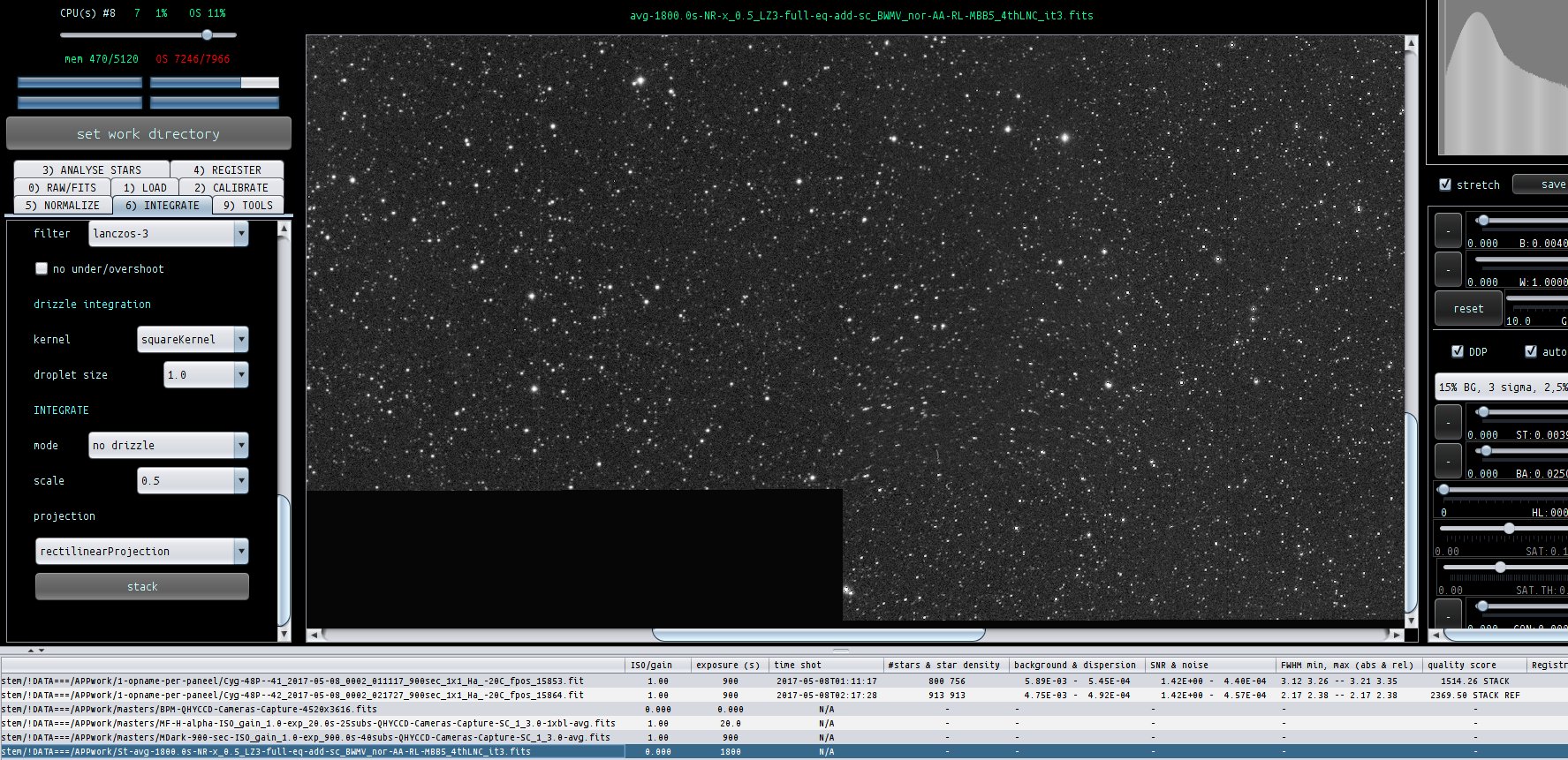

KeesSchererParticipant“Panel 41” is a single exposure light frame that looks good visually with a slightly higher FWHM but why does APP compute these rediculous numbers for star density, quality score and registration RMS? It is the top row in this screen print.

HaverkampParticipantHi @keesscherer,
This is a clear indication that there is a registration problem for this frame for some reason…
Can you register this frame without problems to one of the frames that has overlap with this frame?
Does this error repeat itself with different registration and/or star analysis settings?
Mabula

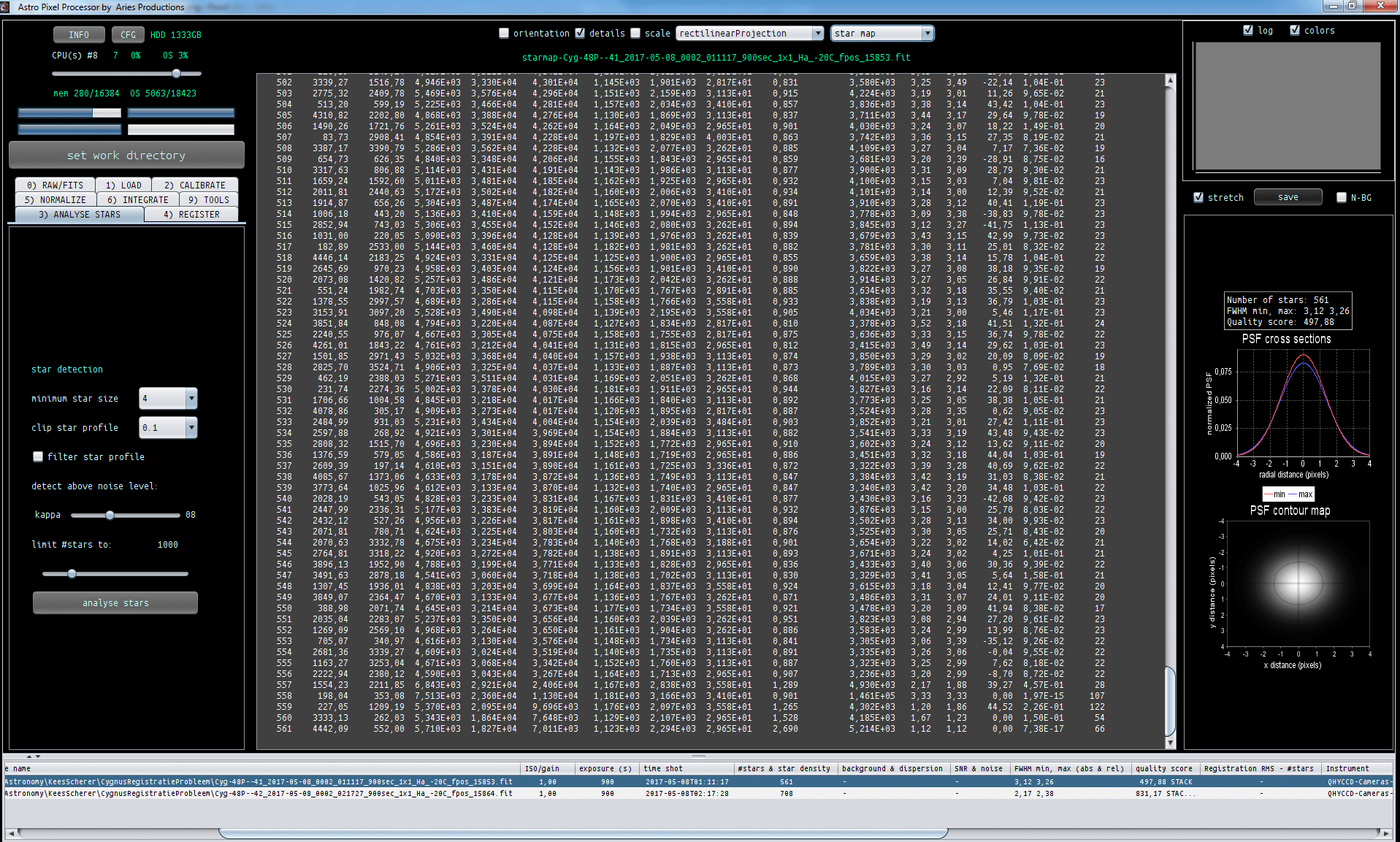

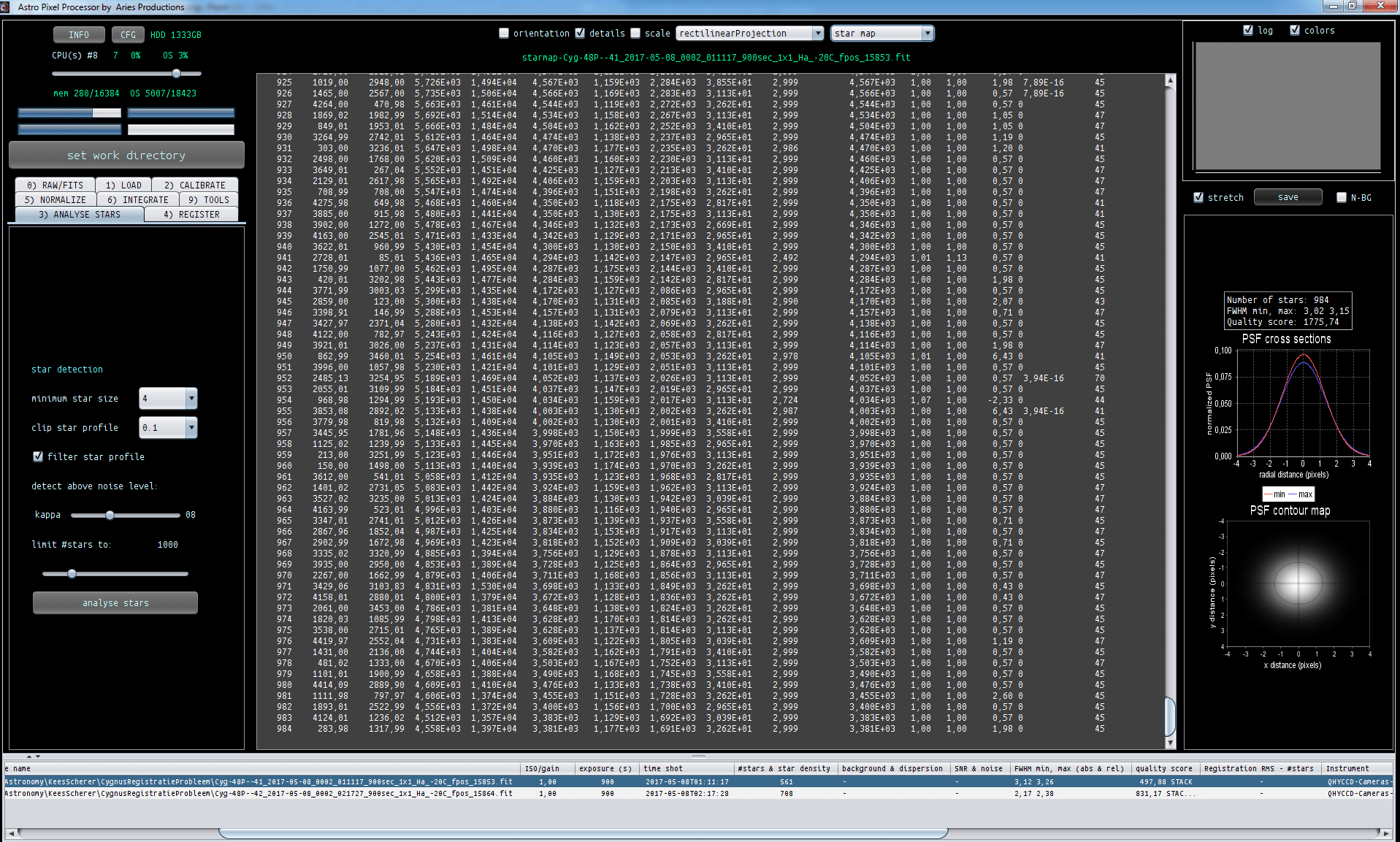

It’s a serious bug, so very happy to have found it. 2 screenshots:
first with “filter star profile” off, the other with “filter star profile” on. The screenshots show the “details” of “star map image viewer mode” on panel 41.
Notice that with filter on, there are stars found with FWHM max, min of 1,00 & 1,00. These are bogus results, the star locations are rubbish as well… This must seriously affect registration in a bad way.
