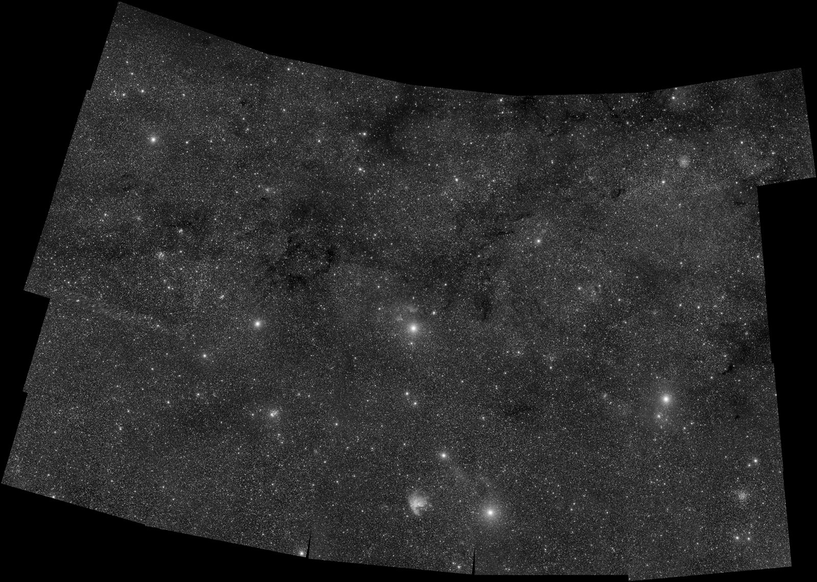

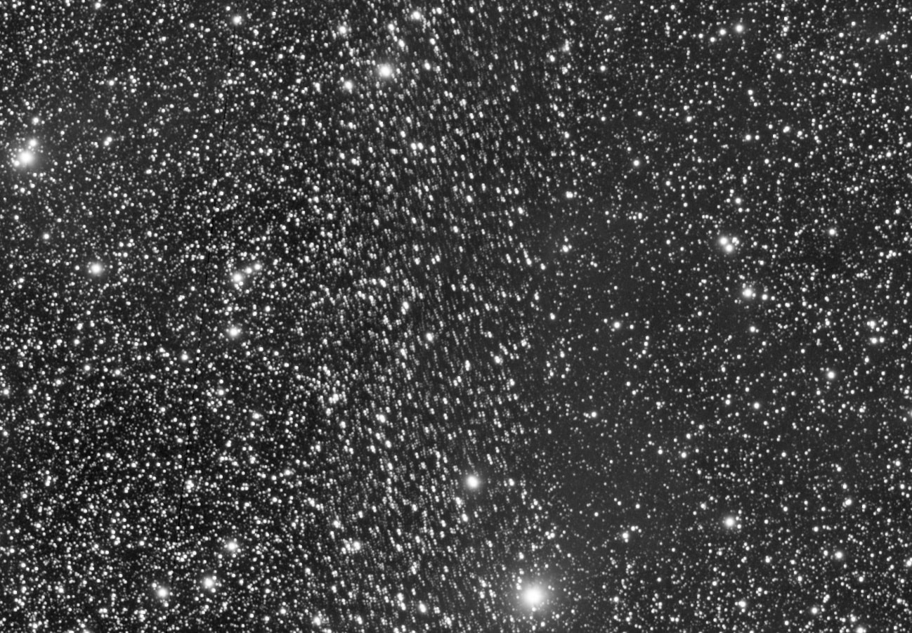

O’DonoghueParticipantHere is an initial 16 pane mosaic. I used files created in Pixinsight. This time I used ones that I had performed the DBE on, so the gradients were removed, but kept the files in Linear mode.
The joining looks really good, except for two areas where the stars are streaked. 2 images attached to test.
I m going to try a 6×6 full frame stitch later.

O’DonoghueParticipantHere is the 25 pane version, used with the DBE files. Very good blending result for brightness, gradients and detail.
Two areas of overlapping show star distortion. Whether these can be joined without issues by other settings I m noy sure yet. More testing to do.
This took 3 hrs on the laptop to put together.
Tom

at 3) Analyse stars,
- set minimum star size to 5-6 and or increase clip star profile to 0.3-0.5, this will help with star lokation precision
- increase the amount of stars limit from 2500 to 5000
- lower the detect above noise kappa value from 8 to 4 (below 3 is unadvisable)
You can enable filter star profile, this could also help in increasing the star lokation precision which could help in getting a better result
I notice some frames have very little overlap right?
When frames have very little overlap, it can help to use triangles instead of quadrilaterals in
4) Register
pattern recognition descriptor shape
That should help in getting those frames that have very little overlap to have better registration.
Let me know if you can improve the result ;-)
